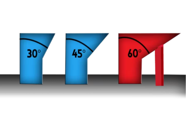

Using the 45-degree rule for supports
The 45-degree rule helps decide when to add supports. It says overhangs steeper than 45 degrees need support. Most printers can handle small overhangs without issues.
Here’s why this rule works:
  • Overhangs up to 45 degrees stay stable by sticking to the layer below.
  • Angles over 45 degrees lose grip, making them likely to fail.
For instance, a 60-degree overhang might print okay, but supports make it better. The table below shows how different angles affect strength:
