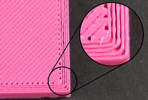

Recognizing Signs of Over-Extrusion
Over-extrusion occurs when your 3D printer pushes out too much filament, causing excess material to accumulate on your model. Symptoms of 3D printer over-extrusion include blobs, stringing, and uneven surfaces. You may also notice that the layers appear overly thick or that the print dimensions exceed the intended size.
Over-extrusion issues often stem from incorrect flow rate settings, excessive printing temperature, or poorly calibrated extruder gears. For example, a high flow rate can cause the printer to deposit more filament than necessary, leading to over extrusion. Similarly, a high nozzle temperature may cause the filament to melt excessively, resulting in poor layer adhesion and surface defects.
To fix over-extrusion, start by calibrating the flow rate and adjusting the extrusion multiplier in your slicing software. Lowering the nozzle temperature can also help reduce filament over-melting. Regularly inspecting and maintaining your extruder gears ensures consistent filament feeding, minimizing over or under-extrusion problems.

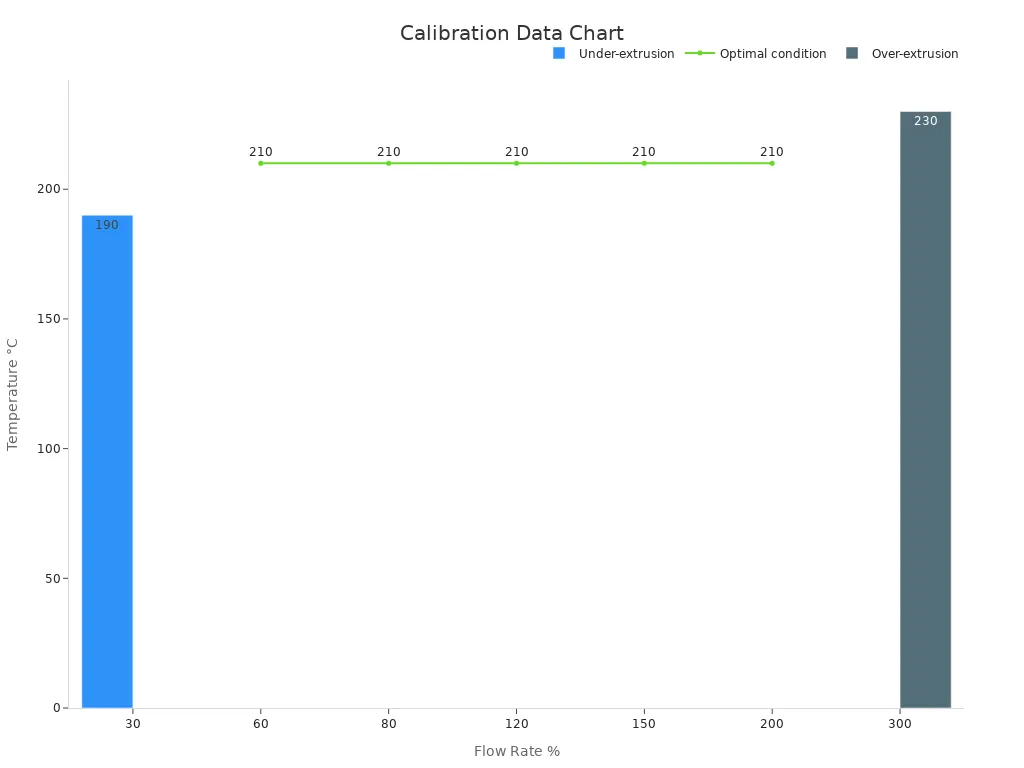

Calibrating Flow Rate and Extrusion Settings
Calibrating the flow rate is essential to address under-extrusion and over-extrusion issues in 3D printing. Incorrect flow rate settings can lead to uneven filament deposition, affecting the structural integrity of your prints. Adjusting the extrusion multiplier in your slicing software allows you to fine-tune the flow rate for optimal filament output.
A study on flow rate calibration highlights the importance of balancing extrusion conditions. For instance, a flow rate of 30% at 190°C results in under-extrusion, while a flow rate of 300% at 230°C causes over extrusion. Optimal conditions occur between 60% and 200% flow rates at 210°C. Use this data to guide your calibration process and achieve consistent results.
Flow Rate (%)
Temperature (°C)
Extrusion Condition
30
190
Under-extrusion
300
230
Over-extrusion
60
210
Optimal condition
80
210
Optimal condition
120
210
Optimal condition
150
210
Optimal condition
200
210
Optimal condition
Chart showing calibration data for flow rate vs temperature by extrusion condition
Regular calibration ensures your printer maintains consistent filament output, reducing the risk of over or under-extrusion.

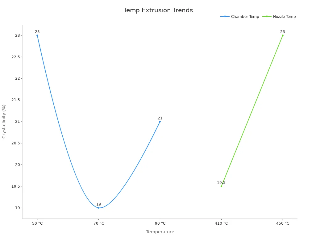

Optimizing Printing Temperature
Printing temperature plays a critical role in extrusion quality. Incorrect temperature settings can cause filament to melt unevenly, leading to under-extrusion or 3D printing over-extrusion. Optimizing the nozzle and bedplate temperatures ensures proper filament flow and adhesion.
Higher nozzle temperatures improve melt viscosity and interlayer bonding. For materials like PEEK, optimal nozzle temperatures range between 400°C and 430°C. A chamber temperature of 50°C yields superior mechanical strength and crystallinity, while higher bedplate temperatures enhance adhesion and crystallization rates.
Temperature Setting
Mechanical Strength
Crystallinity
Chamber Temp: 50 °C
Superior
23%
Chamber Temp: 90 °C
Moderate
21%
Chamber Temp: 70 °C
Lower
19%
Nozzle Temp: 450 °C
Peak Force: 2034 N
23%
Nozzle Temp: 410 °C
Lower Peak Force
19.5%
Line chart showing extrusion quality trends with temperature
By optimizing temperature settings, you can improve extrusion quality and minimize defects in your prints.
