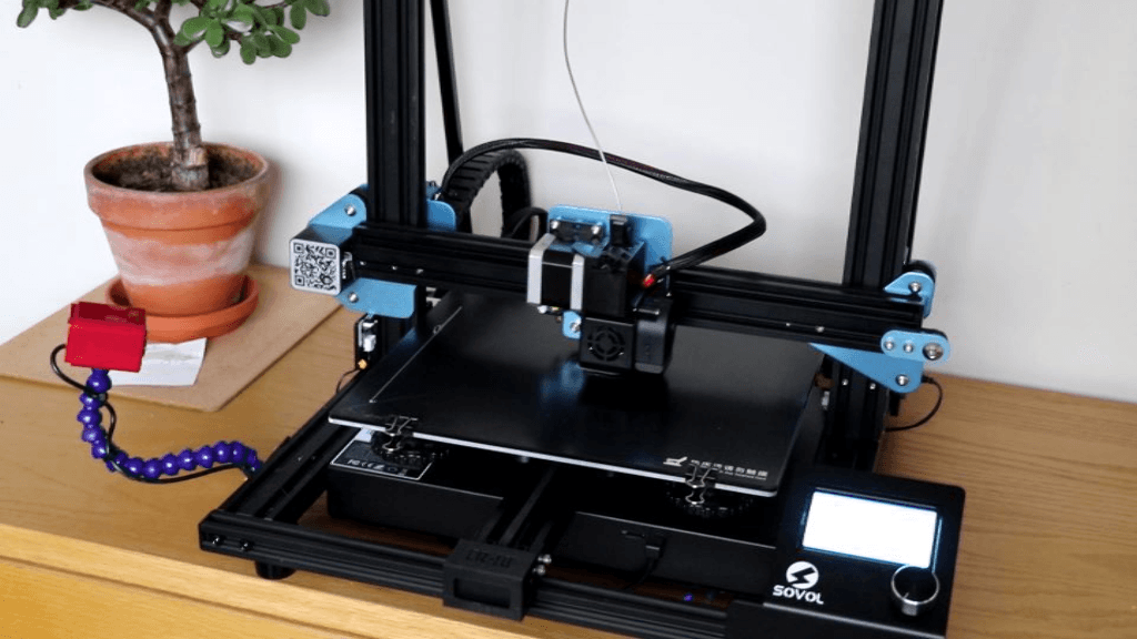

For this I bought a Raspberry Pi and used the Octoprint application.
I used Pi model B, I believe other models can be used but cannot confirm this, I know the Pi Zero has a smaller memory but it may be sufficient.
There is information on this on the Octoprint forum and installation instructions on the Octoprint site.
No need to buy a case for the Pi, plenty of designs on Thingiverse to choose from. I printed https://www.thingiverse.com/thing:604915 which small and fits neatly at the back of the printer. You also need a power supply.
I leave the Pi-powered up all the time and just switch on the printer when needed. When the printer is off and Pi is on, the Sovol screen will be lit as it is being powered by the USB Pi to printer cable. To avoid this, one pin on the USB plug needs insulating and an easy way to do this is to add a slip of paper as shown below and in the video https://youtu.be/neoeAJqdJ_M
The Octoprint app can be downloaded from here https://octoprint.org/
Once installed and set up there is no need to use the micro SD card to load files to the printer ever again. Control of each axis including the extruder can be done from your PC or laptop. Temperature can be seen and adjusted and a webcam can also be plugged into the Pi so the progress can be watched. You can also record a timelapse video of your print.
