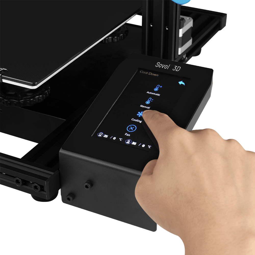

1.New SD card must to be format to the one that can be recognized by the screen.
Start=>> running=>> Input command to enter DOS system(win7 system, please input cmd), input format/q g:/fs:fat32/a:4096.
G is the disk number of your SD card. Please noted that right click to format is invalid; SD card capacity must within 2-16G.
2.Then Put the File I send into the SD card, plug the SD card into the touch screen.
3.Turn on the printer, and it will flash by itself.
4.Power off , remove the SD card and restart.
Then please flash the firmware for the mainboard, connect the printer and computer with usb cable, find out "Update firmware" in Cura software,
