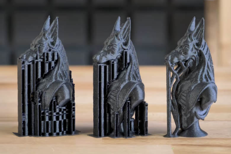

Surface Quality Issues
Imperfections from support contact
When you print models with supports, the areas where the supports touch the model often suffer from poor surface quality. These imperfections are especially noticeable on the underside of the part. The contact points between the supports and the model can leave visible marks, creating a messy appearance. This issue becomes more pronounced when using standard support settings, as the material tends to fuse with the initial layers of the part. Once you remove the supports, the fused material can leave pitted or uneven layers, which detract from the overall quality of your 3d printing project.
The type and spacing of supports also play a significant role in surface quality. For instance:
  • Honeycomb supports often result in rougher surfaces compared to rectilinear supports.
  • A 1mm rectilinear support spacing produces fewer visible marks and a cleaner finish than a 2mm spacing.
By carefully selecting support settings, you can minimize these imperfections, but achieving a flawless surface remains challenging.
