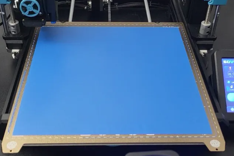

Cleaning the Print Bed for Better Adhesion
A clean print bed is essential for first layer adhesion. Dust, grease, or leftover filament can prevent the filament from sticking properly.
Here’s how to clean the print bed:
  • Use isopropyl alcohol and a lint-free cloth to remove fingerprints and oils.
  • For stubborn residue, use warm soapy water or a scraper.
  • Avoid touching the bed with bare hands after cleaning to keep it free of contaminants.
When you clean the print bed regularly, you’ll notice fewer adhesion issues and smoother first layers.
