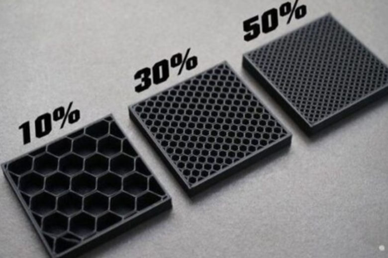

Common Infill Density Levels and Their Uses
Low-density infill (10-20%) for lightweight and decorative prints
Low-density infill, ranging from 10% to 20%, is ideal for projects where weight reduction and material efficiency are priorities. This density level creates a sparse internal structure, making it perfect for decorative items or prototypes that do not require significant strength.
For example, if you are printing a vase or a figurine, a 10% infill density will suffice. It minimizes material usage and reduces print time while maintaining the visual appeal of the object. Lightweight designs like these benefit from the reduced internal structure, as they do not need to withstand heavy loads or stress.
Tip: Use adaptive infill patterns, such as gyroid or honeycomb, to enhance the aesthetics of your decorative prints while maintaining a lightweight structure.
Medium-density infill (30-50%) for balanced strength and efficiency
Medium-density infill strikes a balance between strength and material efficiency. This range, typically between 30% and 50%, is suitable for functional parts that require moderate durability without excessive material consumption.

Medium-density infill is ideal for applications like enclosures, brackets, or prototypes that need to balance strength and material usage.
