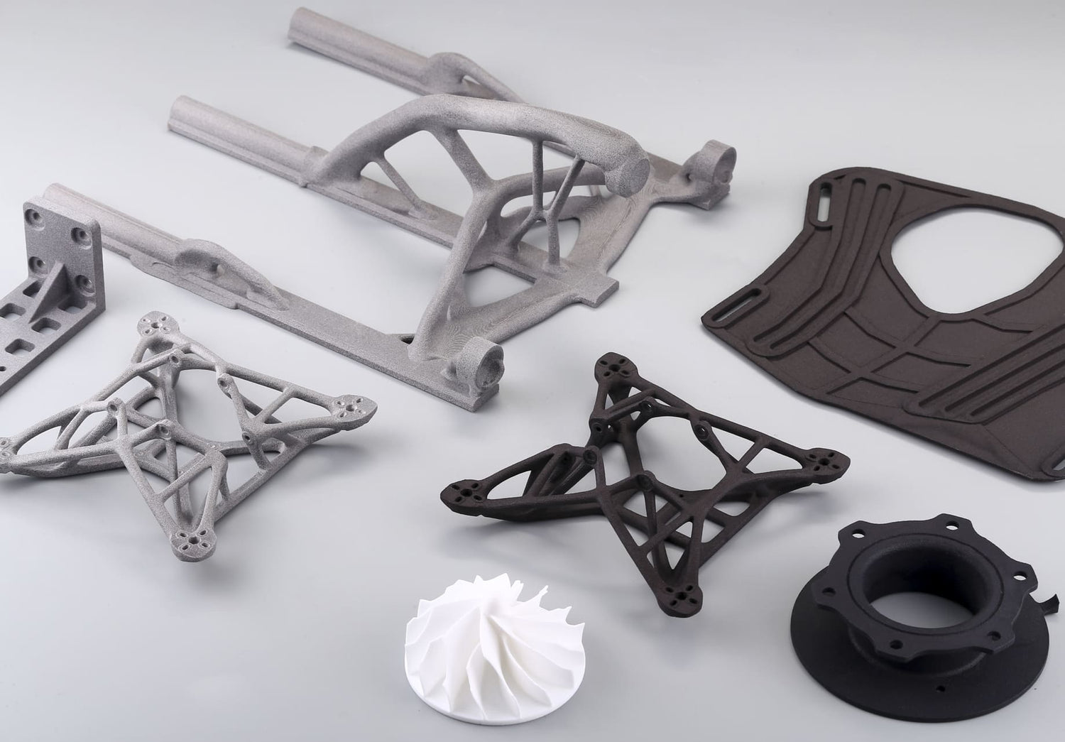

Choosing the best materials for 3D printing car parts is crucial. The materials must effectively handle stress, heat, and wear. For instance, engine covers or brackets need to withstand high temperatures. When replacing old parts, it's essential to use materials that are both strong and flexible. If you're creating parts for moving systems, they must be durable enough to resist wearing out. A large 3D printer enables you to produce larger car parts with ease. Understanding these requirements is key to creating robust 3D printed car parts.
- Pick materials based on needs like heat and impact resistance. This helps parts last longer and stay strong.
- Lightweight materials make cars faster and save fuel. Try using carbon fiber or nylon mixes.
- Check product info sheets to learn about material features. This helps you choose the best material for your car part.
- Test materials in real situations to see if they work well. This avoids problems and makes parts more reliable.
- Change printer settings to match the material you use. Good settings make parts stronger and more precise.

Lightweight Materials for Efficiency
Using lightweight materials helps cars work better. Lighter parts make vehicles weigh less. This improves fuel use and driving performance. Electric cars can go farther with lighter parts because the battery lasts longer.
Some materials are great for 3D printing car parts. Carbon fiber composites are strong and light. They are good for brackets and panels. Nylon blends are durable and flexible. They are useful for parts that need strength but not extra weight.
Tip: Think about where the part will be used. Lightweight materials may need extra support in high-stress areas.
Another good choice is polycarbonate (PC). It is light and tough, perfect for headlights or inside parts. For chemical resistance, PETG is a smart option. It is strong and keeps the weight low.
Designing parts carefully can also save weight. Shapes like honeycombs use less material but stay strong. Many 3D printing programs let you test designs before making them.
Picking lightweight materials and smart designs makes car parts better and more efficient.
