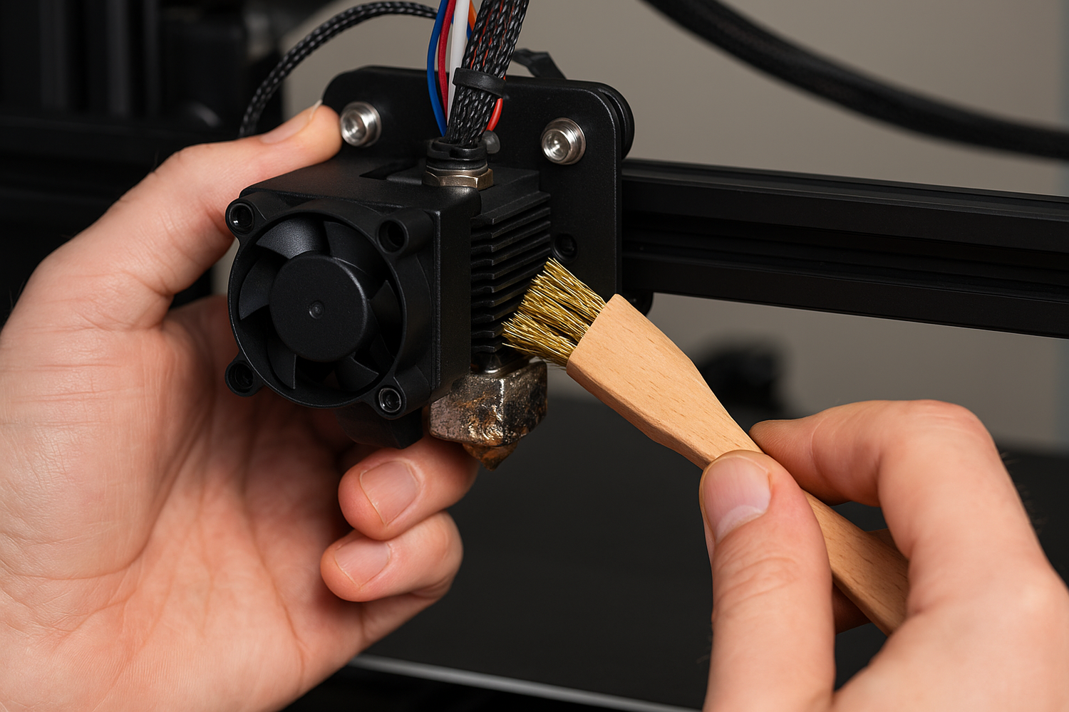

  4. Brush the exterior: Use a brass brush to clean the outside of the nozzle. This removes any burnt filament stuck to the surface.

  3. Scrape gently with a brass brush: PETG can stick to the nozzle’s exterior. Use a brass brush to scrape it off without scratching the nozzle.
