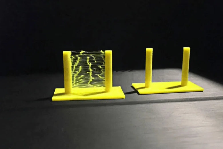

You may notice thin, hair-like strands of plastic stretching between parts of your 3D print. This is called stringing or oozing. These unwanted threads form when your printer moves the nozzle across open spaces without printing. Stringing or oozing can leave your prints looking messy and reduce print quality. You might see surface defects, wasted material, or even small blobs on your finished object. While stringing or oozing usually does not destroy the mechanical strength of your print, it can introduce tiny flaws that affect the look and sometimes the performance of your part.
Tip: If you spot excessive stringing, check your print settings before starting another job. Quick adjustments can help you avoid stringing issues and improve your results.

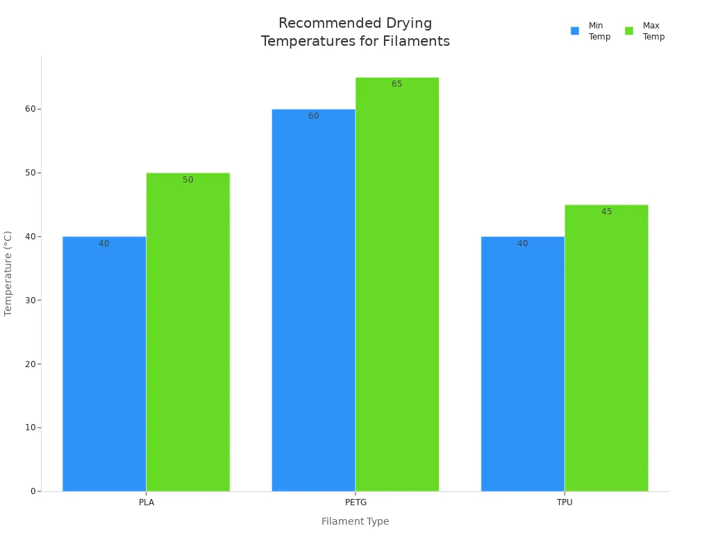

You can prevent stringing by making sure your filament stays dry. Moist filament causes many problems during printing. When moisture gets into PLA, PETG, or TPU, it turns into steam inside the hot nozzle. This creates bubbles, rough surfaces, and weak layer adhesion. You might hear popping or sizzling sounds, which means your filament needs drying.
To reduce stringing, use proper filament drying methods for each material. The table below shows the best drying temperatures and times:
Filament Type
Recommended Drying Temperature (°C)
Recommended Drying Time
Notes
40-50
4-6 hours
Use low heat; avoid over 60°C.
60-65
4-6 hours
Moderate heat; avoid over 70°C.
TPU
40-45
4-6 hours
Keep below 50°C.
Bar chart comparing minimum and maximum recommended drying temperatures for PLA, PETG, and TPU filaments.
For Sovol printers, users report less stringing when they dry filament before printing and set temperatures 5-10°C lower than usual. Always check your Sovol Cura settings, as they often work well out of the box.
