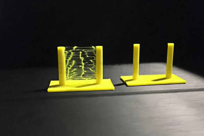

3D Printing Stringing Causes
What Is Stringing or Oozing
You may notice thin, hair-like strands of plastic stretching between parts of your 3D print. This is called stringing or oozing. These unwanted threads form when your printer moves the nozzle across open spaces without printing. Stringing or oozing can leave your prints looking messy and reduce print quality. You might see surface defects, wasted material, or even small blobs on your finished object. While stringing or oozing usually does not destroy the mechanical strength of your print, it can introduce tiny flaws that affect the look and sometimes the performance of your part.
Tip: If you spot excessive stringing, check your print settings before starting another job. Quick adjustments can help you avoid stringing issues and improve your results.

What causes stringing in 3D printing?
Stringing happens when melted filament leaks from the nozzle during travel moves. You often see this with incorrect retraction settings, high print temperatures, or wet filament. Sovol printers and quality filament help reduce these issues.
