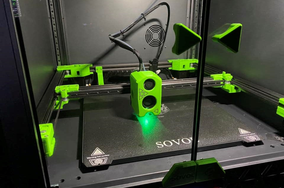

How to Use a 3D Printer
Learning how to use a 3d printer can feel like a big task, but you can break it down into simple steps. This part will guide you through the 3d printing procedure, from setting up your machine to watching the first layers come to life. Let’s get started!
Set Up and Calibrate
You need to start with a solid 3d printer setup. Place your printer on a sturdy table. Make sure nothing wobbles. Plug in your machine and check that all cables are secure. Many beginners skip calibration, but this step is key. About 70% of print failures happen because of poor calibration. You want your prints to look good and stick to the bed.
