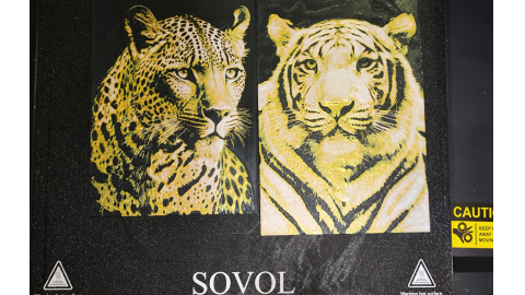

In simple terms, HueForge converts 2D images into multicolor 3D printed objects without the use of multicolor printers or setups. How do you create color complexity without extruding multiple colors? By stacking different color layers of filament on top of one another. Due to the inherent translucence of filament, the stacked layers combine to form different gradients and blends where the light passes through. Within this stacking, the magical illusion takes shape.
HueForge calculates the precise thickness and blending needed to produce the correct color gradients and ensure everything blends seamlessly to form a detailed image. The result is a 3D printed object that looks far more complex and refined than its 2D counterpart, without needing to melt and mix filament (and requiring a setup that can do this).
It starts with a 2D graphic, of course. The software turns it into a black-and-white image to help it better distinguish between light and dark areas. If you increased the layer height it would make that layer darker (and vice versa if you decreased it), because of the filament’s transparency. Plus, you can specify the colors you want to use and HueForge will calculate how to blend them for optimal results.
The software then generates a text file with the color changes and filament swap instructions. This allows the printer to pause and prompt you to change filaments at the appropriate layers, ensuring that the final print looks as intended.

Start your slicer. For reference, we’ll be working with Sovol SV06 ACE:An open source 3D printer from Sovol. Set Layer height 0.08mm,first layer height 0.16mm.
Import the STL. Depending on the size and layer height, it might take a few minutes to load, so be patient.
From the settings, ensure that no supports are enabled and that infill is set to 100%.
Slice the STL. Again, because of the settings, it might take a few minutes.
Manual Filament Change
Depending on the slicer, the following steps might be slightly different. But if you’re in Ocra…
2.Right click on the ‘+’ and select “Add Custom G-code”,Enter"M600".
start with black
swap to red at layer #9
swap to white at layer #15
3.Slice the model.
Once you’ve sliced the final model and you’ve sent it to your printer, be sure to stand by to make the necessary manual change of filament without risking the print cooling down too much. Because there won’t be an automatic purge, you might want to extrude a bit more filament to confirm that the previous color has been fully removed from the nozzle.
