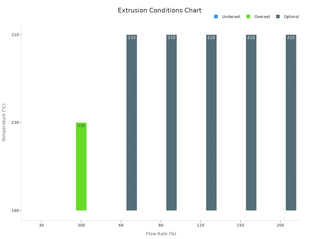

Clogged or partially blocked nozzle
A clogged nozzle is another reason for uneven extrusion. Old material, dust, or dirt can block the nozzle. This stops the flow and causes gaps or jams. Cleaning the nozzle often helps avoid these problems.
Signs of a clogged nozzle include uneven flow or missing layers. If your print has lines that spread out over time, the nozzle might be blocked. A clogged nozzle can also mess up the first layer, making it stick poorly to the bed.
To fix a clogged nozzle, heat it to the melting point of your filament. Use a cleaning needle or tool to clear out debris. If the clog doesn’t go away, try the cold pull method. Heat the nozzle, insert filament, let it cool, then pull it out. This removes stuck material. If nothing works, replace the nozzle.
Tip: Clean your nozzle regularly to avoid clogs. Using high-quality filament also helps reduce buildup, making your prints smoother and more reliable.

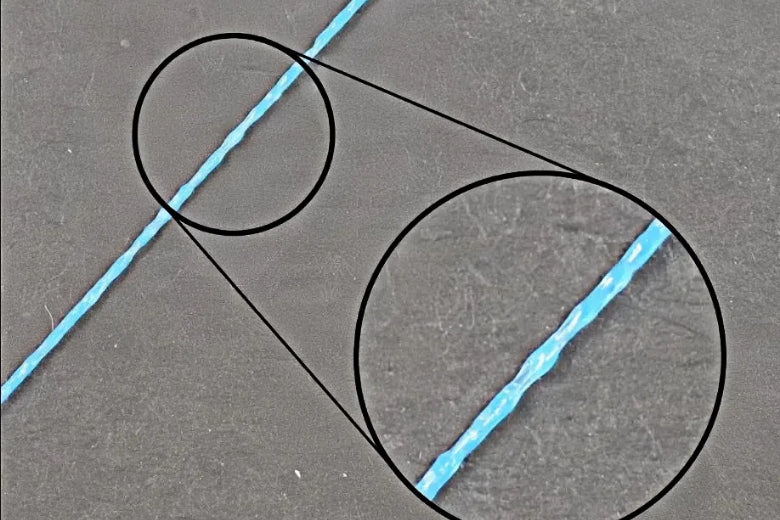

Inconsistent filament diameter
Uneven filament thickness often causes extrusion problems. If the filament diameter changes, the flow rate becomes unpredictable. This can create gaps, weak spots, or uneven layers in your print. For example, thicker filament sections may cause over-extrusion, while thinner ones lead to under-extrusion. These changes make it hard to get smooth and accurate prints.
To spot this issue, measure the filament diameter at different points with a caliper. Compare the numbers to the maker’s specs. If the thickness varies too much, the filament may not be good for detailed printing. Even small changes can mess up the extrusion process and lower print quality.
