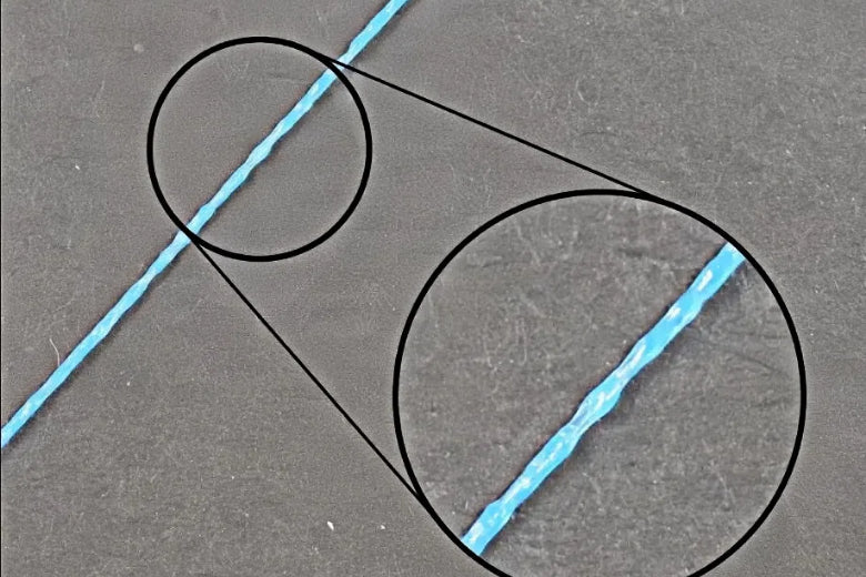

Identifying Inconsistent Extrusion in 3D Printing
Common signs of inconsistent extrusions
When a 3D printer has extrusion problems, it leaves clues. Spotting these signs early saves time and material. Here are some common signs:
Indicator |
Description |
Inconsistent filament shape |
Filament that changes shape during the printing process. |

Inconsistent filament diameter
Uneven filament thickness often causes extrusion problems. If the filament diameter changes, the flow rate becomes unpredictable. This can create gaps, weak spots, or uneven layers in your print. For example, thicker filament sections may cause over-extrusion, while thinner ones lead to under-extrusion. These changes make it hard to get smooth and accurate prints.
To spot this issue, measure the filament diameter at different points with a caliper. Compare the numbers to the maker’s specs. If the thickness varies too much, the filament may not be good for detailed printing. Even small changes can mess up the extrusion process and lower print quality.
