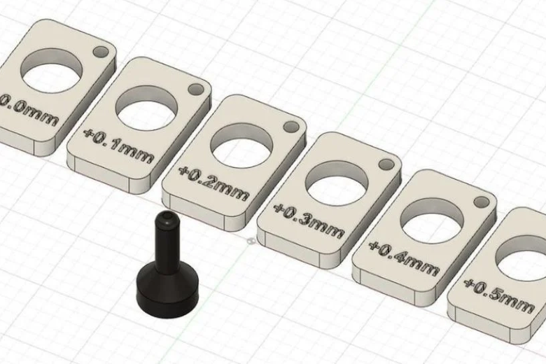

Testing and Measuring Printing Tolerances
Tools for measuring tolerances (e.g., calipers, micrometers)
To check tolerances, you need proper tools. Calipers and micrometers are great for measuring 3D-printed parts. Calipers can measure inside, outside, and depth sizes. Digital calipers are very accurate, often showing results to 0.01 mm. This makes them useful for checking tight tolerances. Micrometers are even more precise, measuring small details up to 0.001 mm.
For advanced checks, use tools like surface scanners or CT scans. These create detailed 3D models of your parts. You can compare these models directly to your design.
A study looked at ways to measure 3D-printed heart models. It found that CT scanning solves many problems other methods face. CT scans allow direct comparison of the printed model to the patient’s anatomy.
Techniques for testing dimensional accuracy
Testing accuracy ensures parts match the design. Start by printing a test object, like a calibration cube. Use calipers or micrometers to measure it. Check for size differences and adjust your printer settings if needed.
A study compared SLA and FDM printers using jaw models. It showed both methods work well in dental practice. FDM prints were as accurate as SLA prints.
FDM prints may need extra steps like sanding to meet strict tolerances. Advanced control methods in 3D printing also improve accuracy.
- FDM parts often need extra work to meet standards.
- Advanced control methods help improve FDM accuracy.
Iterative testing and refining for a perfect fit
Getting a perfect fit takes testing and improving. Print a prototype, measure it, and find areas to fix. Change your design or printer settings and try again until it fits right.
