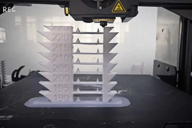

Printing and mechanical stress can also cause brittle PLA filament. If you use incorrect print settings, such as printing at too low a temperature, the layers do not bond well. This makes your prints weak and brittle. Printing at too high a temperature can degrade the filament, leading to more breaking and reduced durability.
Mechanical stress happens when you pull filament straight from the spool. PLA is stored in a curved shape, and forcing it straight puts tension on the material. This stress can cause filament breaking, especially if the filament already has moisture problems or has aged in poor storage conditions.
You may also see problems if you use high print speeds or excessive cooling. Fast printing does not give layers enough time to fuse, and too much cooling can make the layers brittle. Both issues lead to filament breaking and poor print quality.

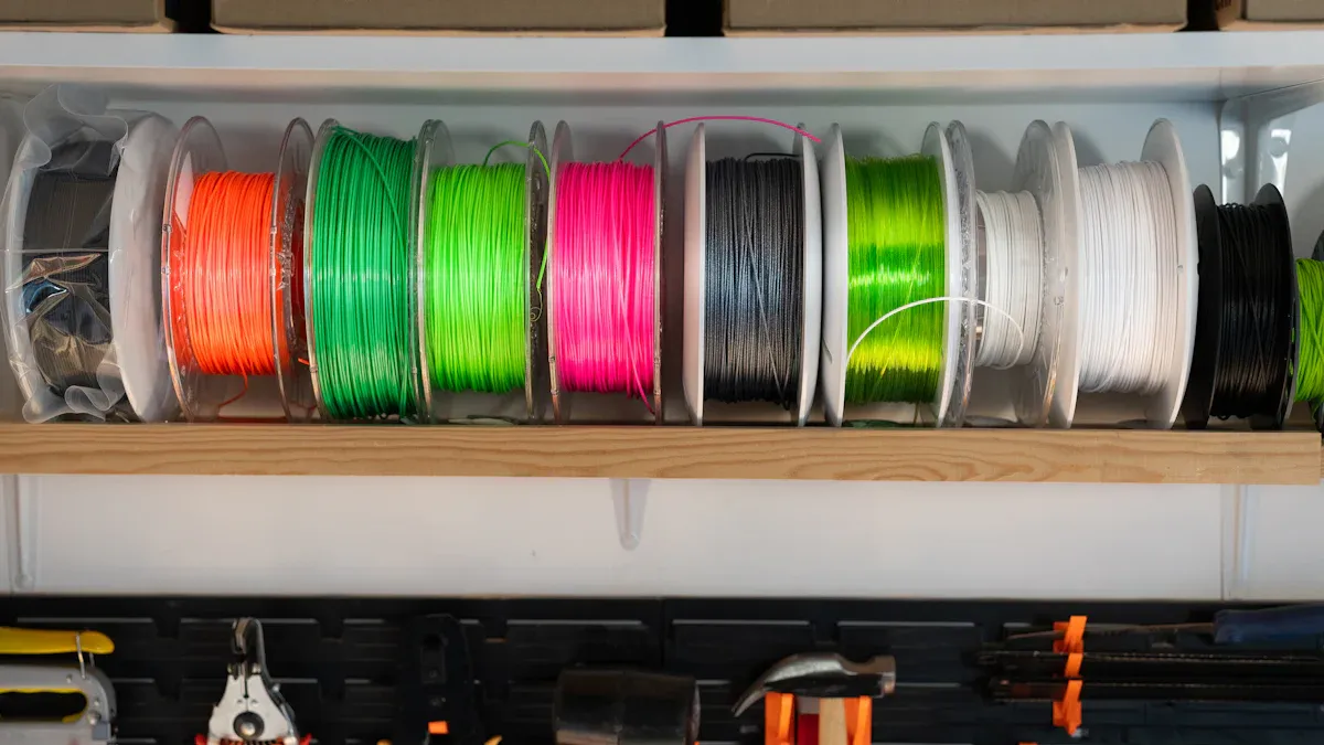

You need to focus on storage to keep PLA filament in good condition. Moisture is the main cause of brittleness, so you must keep your filament dry and away from humidity. The best way to do this is by using airtight containers or vacuum-sealed bags. Add desiccant packs, such as silica gel, to absorb any stray moisture inside the container. This combination creates a humidity-controlled environment that protects your filament from problems caused by water absorption.
Here are some effective storage solutions:
Tip: Regularly check the humidity inside your storage containers with a hygrometer. Replace or recharge desiccants when needed to maintain optimal conditions for storing PLA.

Maintaining the right environment is key to proper storage and handling of PLA filament. You should store filament in a place with stable temperature and low humidity. The ideal temperature range for PLA is between 20°C and 25°C (68°F to 77°F). Relative humidity should stay below 40%, with 20-25% being even better for long-term storage.
To create optimal conditions for storing PLA filament:
  • Use sealed polypropylene boxes with gaskets for the best moisture protection.
  • Place bone-dry desiccants inside storage containers.
  • Monitor humidity with a hygrometer and replace desiccants when needed.
  • Store different filament types separately to avoid cross-contamination of moisture.
  • Avoid storing filament near windows, heaters, or in rooms with frequent temperature swings.
  • Regularly inspect your storage setup for leaks or signs of moisture.
