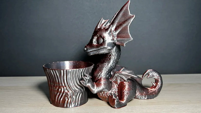

Featured above is a Dragon model with automatic organic tree supports generated in Orca slicer. Such models may be challenging for some printers as more slicer settings need to be tuned in order to print it well. I was pleased to see the SV08 profile in Orca is well-tuned, as I am completely satisfied with the print result.

3D prints can be both functional and aesthetically pleasing for everyday items, adding stunning details. In this section, I selected a few models to test the printer’s ability to produce high-detail prints that are practical, not just for display. The Dragon pot planter from 3DWithUs is an excellent example of this.
This model is particularly challenging as it requires a lot of supports. This is where Orca Slicer comes in handy, as their organic tree supports are placed automatically and do the job. The model was printed without issues, and dual filament landed very well on the model, featuring a specific color shade on each side.
