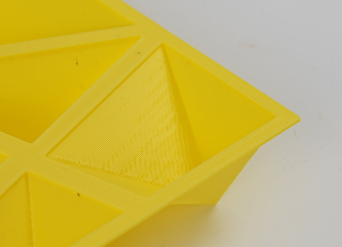

When you check your 3D prints, you might see tiny lines or bumps. These go up and down the sides. These lines are called vfas (vertical fine artifacts). You can spot them as straight or slanted lines, small bumps, or even little ridges. Sometimes, you need to look very closely or use a bright light to see them. This is especially true if your print is shiny. Most of these artifacts are between 10 and 40 micrometers wide. They are hard to notice from far away. But if you look closely, you can see them better.
Tip: Hold your print near a window or lamp. Move it around and look for lines or patterns that repeat along the Z-axis. These are signs of vfas.
You might also see vfas with about 2mm between each one. This means the lines or bumps show up every 2 millimeters on the print. If you see these repeating marks, you are looking at a common vfa.
Surface Patterns
Artifacts do not show up in random spots. You will usually find them in a repeating pattern. These patterns match the Z-axis of your printer. The space between each artifact stays the same all over the print. For example, you might see vfas with about 2mm between them from top to bottom. This even spacing helps you know they are vfas and not another problem.
