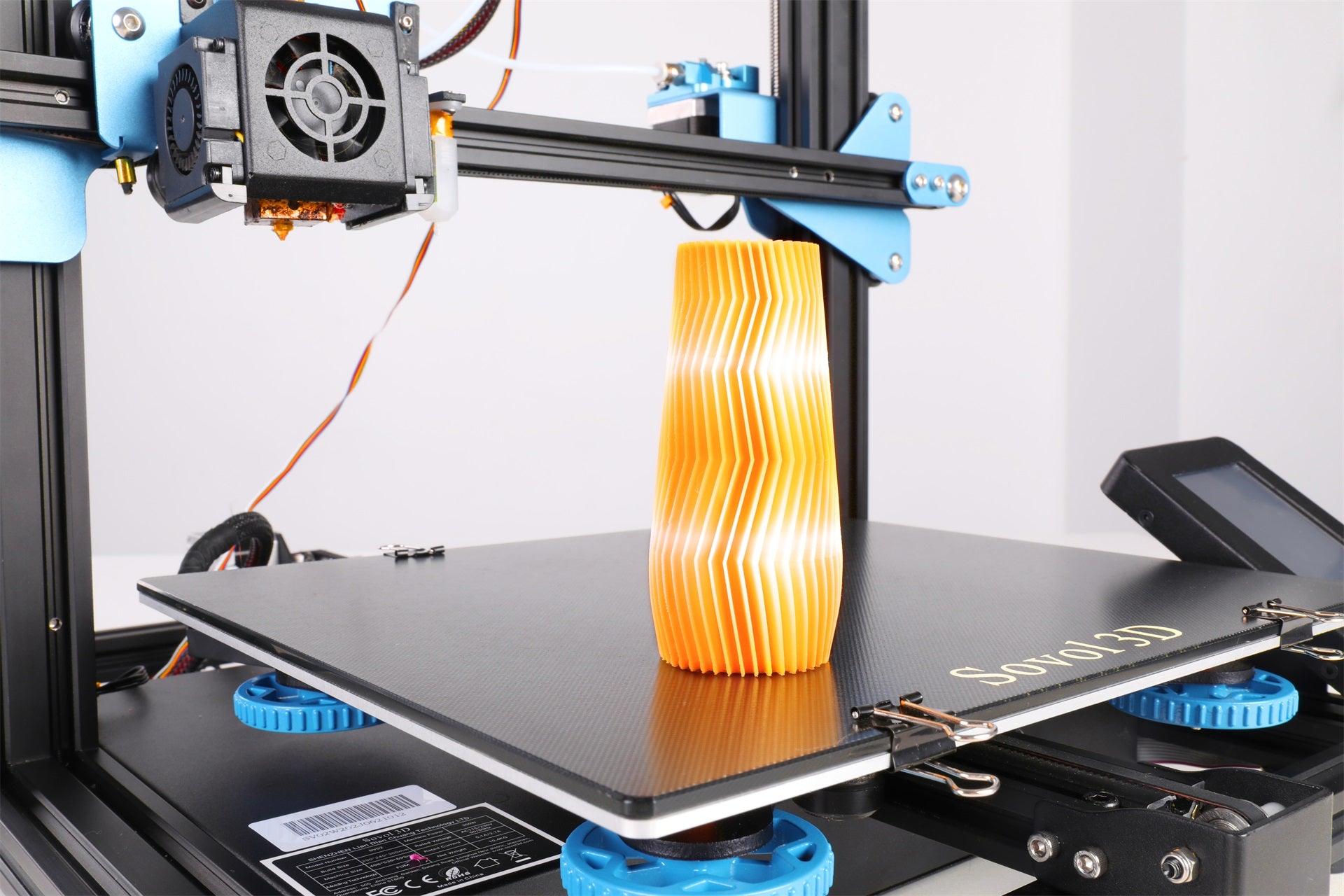

On the white frame, you can adjust the parameters of mixing color, the value can be among 0 to 100, the left one is for extruder 1, the right one is for extruder 2. During the printing, the pringing page will show the mode and the propotion of the mixing color.
Set Gradient Mode
On Mixer page, hit Actve V-tool , you can adjust the parameters,the value can be among 0 to 15.
Hit Gradient, you can enter Gradient page, and hit Aisa V-tool to adjust the parameters, the value can be among 0 to 15. The value of Actve v-tool and Alisa V-tool should be same.
Start Z means the height of the beginning. End Z means the height of the ending,
The value of Start Z should be less than the model. In the printing process, the page will show the mixing model and the mixing proption
