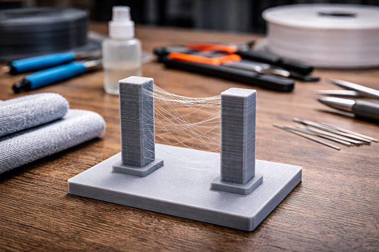

How do you know if filament is wet? There are some easy clues. First, listen for popping or crackling sounds while printing. This happens when water in the filament turns to steam. Second, check for stringy or messy plastic on your prints. Wet PLA often leaves thin strands behind. Third, look at your print’s surface. If it’s rough, bubbly, or uneven, moisture is likely the problem. These signs can be annoying but show your filament needs drying.
How wet filament affects prints
Wet filament makes printing harder and weakens your prints. Prints made with wet filament often break easily because of weak layers. The quality also drops, with rough textures and flaws. A study by Hadi et al. (2023) found drying nylon makes prints stronger and last longer. Some manufacturers warn that PLA can become unusable after just one hour in humid air. Here’s a simple table showing how moisture affects filament:

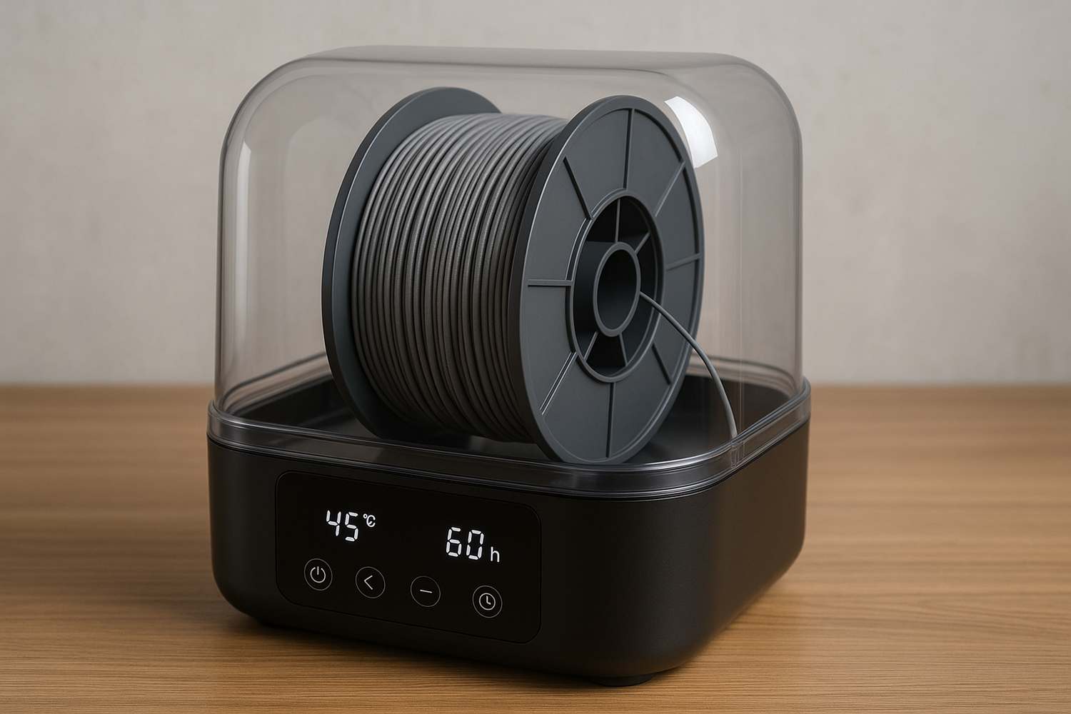

Filament Dryers
Filament dryers are special tools made to dry filament. They use heat and airflow to remove moisture quickly. These devices are easy to use and work well for wet PLA or other sensitive materials.
Why filament dryers are great:
  • They keep a steady temperature, drying filament evenly without overheating.
  • Airflow speeds up drying, making it faster than silica gel.
  • Some dryers let you print directly from them, keeping filament dry while printing.
For example, filament dryers can restore nylon and ABS for better prints. If you print often, a filament dryer can save time and improve results.
Pro Tip: Choose a filament dryer with adjustable temperature settings. This helps you dry different filament types safely.
