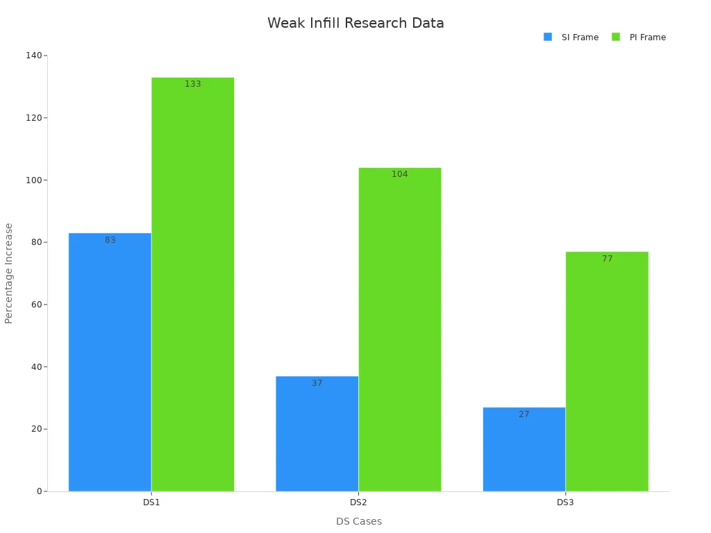

Studies show weak infill affects how strong 3D prints are. For example, research comparing frame types found SI frames had up to 83% better strength (μDS) than PI frames. This proves infill design matters for durability.
Frame Type
μDS for DS1
μDS for DS2
μDS for DS3
SI Frame
83% better
37% better
27% better
PI Frame
133% better
104% better
77% better
Bar chart comparing μDS percentage increase across DS cases for SI and PI frames
