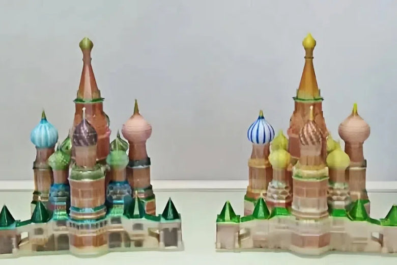

Alcohol Inks for Bright and Bold Colors
Why Alcohol Inks Are Special
Alcohol inks are great for making 3D prints colorful. They dry fast because they are alcohol-based. This keeps the colors bright and bold. These inks also work well with resin prints. They don’t mess up the curing process. When mixed with epoxy resin, they create cool effects. This adds depth and makes your designs stand out. If you want your prints to look amazing, try alcohol inks.
Tools and How to Use Them
Here’s a simple guide to tools and methods:
Method
Tools Needed
Good Things
Challenges
Dying SLA Parts After Printing
- Clear or Flexible Printed Model
Can color many parts at once
Can get a bit messy
- 10 mL Alcohol Ink : 1 L IPA for light colors
No dye in the Form Wash
- 20 mL Alcohol Ink : 1 L IPA for dark colors
Doesn’t waste resin cartridges
- Finish Kit
- Gloves
Printing With Dyed Resin
- 10 mL Alcohol Ink
Easy to set up
Must use all dyed resin at once
- One Liter of Clear Resin
Evenly colored parts
Only one color per print
- Syringe
No extra steps after printing
- Gloves
Coloring Hollow Parts
- Multi-material acrylic paint
Can see inside hollow areas
A bit harder to do
- Syringe or Pipette
- Gloves
These tools help you try different ways to use alcohol inks.
How to Get Amazing Results
Start by cleaning your 3D prints to remove dust. For dying, mix alcohol ink with isopropyl alcohol (IPA). Use 10 mL ink per liter of IPA for light colors. For darker colors, use 20 mL ink per liter. Soak your parts in the mix until the color sets. For hollow parts, use a syringe or pipette to spread the ink inside evenly.
Once the ink dries, your parts will look bright and full of life. The colors will have a rich and deep look. To keep them looking great, seal them with a clear coat. This will protect the colors and make them last longer.
