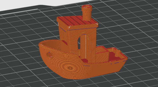

Adjusting Layer Height for Smooth Finishes
Layer height plays a crucial role in determining the smoothness of your prints. Thinner layers, such as 0.10 mm, are ideal for achieving high detail and smoother surfaces. This is especially true for models with curves or intricate features. By reducing the layer height, you minimize the visible "stair-stepping" effect, resulting in a more polished appearance.
Using variable layer heights can further enhance your results. For example, you can apply thicker layers in less detailed areas and thinner layers in sections requiring precision. This approach balances print quality and efficiency. However, proper calibration is essential when adjusting layer heights. Without it, you risk uneven prints or poor layer adhesion, which can compromise the final look.
Research shows that layer thickness significantly impacts surface roughness. As layer thickness increases, surface roughness also increases due to larger gaps between filaments. To achieve better aesthetic results, prioritize thinner layers and ensure your printer is well-calibrated.
