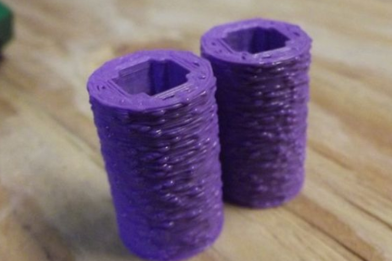

Moisture in filament is one of the leading causes of 3D printing defects, such as blobs, zits, and surface imperfections. Filaments like PLA, ABS, and PETG are hygroscopic, meaning they absorb moisture from the air. When you use a filament with high moisture content, the water inside the material turns into steam as it passes through the nozzle. This creates bubbles in filament, leading to over-extrusion, poor layer adhesion, and visible zits on your prints. Additionally, moisture can weaken the mechanical properties of your prints, reducing their overall quality and durability.

An inefficient cooling system can cause several 3D printing defects, including bubbles, blobs, and zits. When the cooling fan fails to regulate the nozzle temperature effectively, the filament may overheat. This overheating can lead to over-extrusion, which creates visible surface imperfections like blobs and zits. Additionally, inadequate cooling can affect layer adhesion, resulting in weak prints with poor structural integrity.
Another common issue arises when the cooling system is inconsistent. Uneven cooling can cause the filament to solidify irregularly, leading to defects such as bubbles in filament or poor layer alignment. These problems not only reduce print quality but also make it harder to achieve smooth, bubble-free prints.

High temperatures can significantly impact your 3D prints, often leading to defects like blobs and zits. When the nozzle temperature exceeds the recommended range for your filament, the material may become too fluid. This excessive fluidity can cause over-extrusion, resulting in extrusion irregularities such as blobs on the surface of your print. These imperfections not only affect the aesthetic quality of your prints but also compromise their structural integrity.
Additionally, high temperatures can cause the filament to degrade, releasing gases that form bubbles in filament. These bubbles contribute to surface imperfections and weaken layer adhesion. For example, studies have shown that bubble formation is linked to specific temperature thresholds, particularly when multivalent oxides like cerium are thermally reduced. By avoiding excessively high nozzle temperatures, you can minimize the risk of 3D print blobs and other defects.

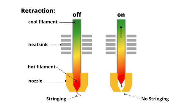

When calibrating, consider other factors like retraction settings and cooling. Retraction helps reduce extrusion irregularities, while proper cooling prevents overheating. Adjusting temperature and retraction settings together ensures smoother prints with minimal surface imperfections. Regular calibration not only avoids defects but also enhances the overall reliability of your 3D printer.

Retraction settings control filament flow during nozzle movement. Proper adjustments minimize over-extrusion, reducing blobs and improving the surface quality of your 3D prints.
