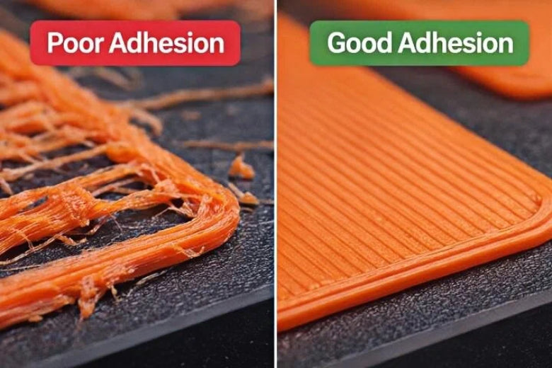

How to Fix First Layer Adhesion Issues in 3D Printing
Why 3D prints fail on the first layer: Fix adhesion issues by adjusting nozzle height, leveling the bed, and cleaning the print surface for better results.
