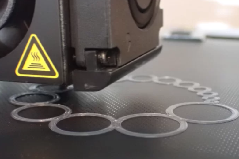

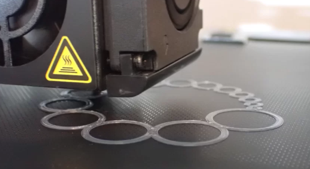

Adjust the Nozzle Height
Why Z-Offset Matters for Bed Stickiness
The Z-offset is important for good stickiness between the nozzle and bed. It adjusts the gap so the nozzle isn’t too high or too low. If the nozzle is too high, the filament won’t stick well to the bed. If it’s too low, the filament gets squished too much and spreads unevenly.
Different materials need different Z-offset settings. For example, PLA sticks better with a little compression on the bed. But PETG works best when the nozzle is slightly higher. Setting the right Z-offset helps the first layer stick better and avoids problems like warping or parts coming loose.
Steps to Set the Right Nozzle Height
Fixing the nozzle height is easy and helps improve printing. Follow these steps to set it correctly:
  1. Level the bed first: Make sure the bed is flat before adjusting the nozzle.
  2. Heat the bed and nozzle: Warm them to printing temperature to match real conditions.
  3. Use a paper or gauge: Place it between the nozzle and bed to check the gap.
  4. Adjust the Z-offset: Lower the nozzle until it just touches the paper. The paper should move with slight resistance.
  5. Test with a print: Print a small pattern to see if the first layer sticks well. Adjust more if needed.
By setting the nozzle height properly, you can fix stickiness issues. This simple step makes sure the filament stays on the bed and prints come out better.

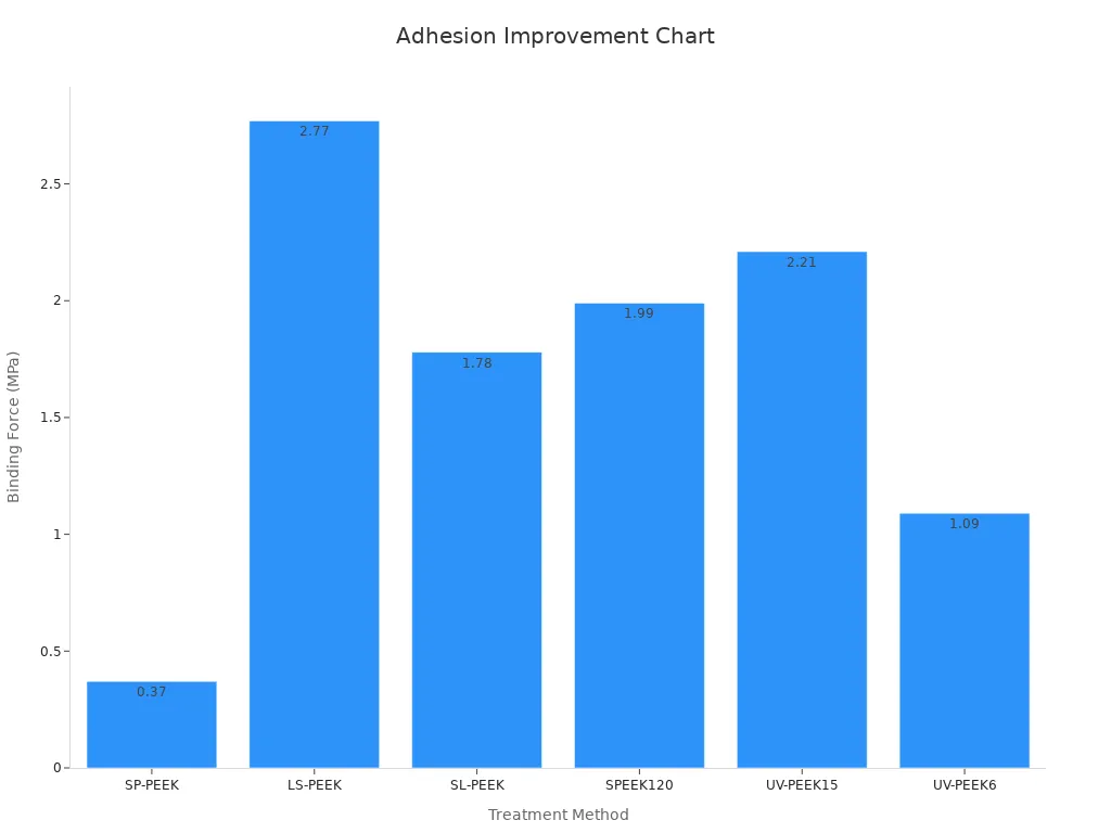

Making 3D prints stick better needs seven simple steps. These are leveling the bed, fixing nozzle height, cleaning the surface, setting the right bed heat, using adhesives, picking the best build surface, and changing print settings. These steps make prints stick stronger, as shown below:
Bar chart showing binding force improvements across treatment methods
