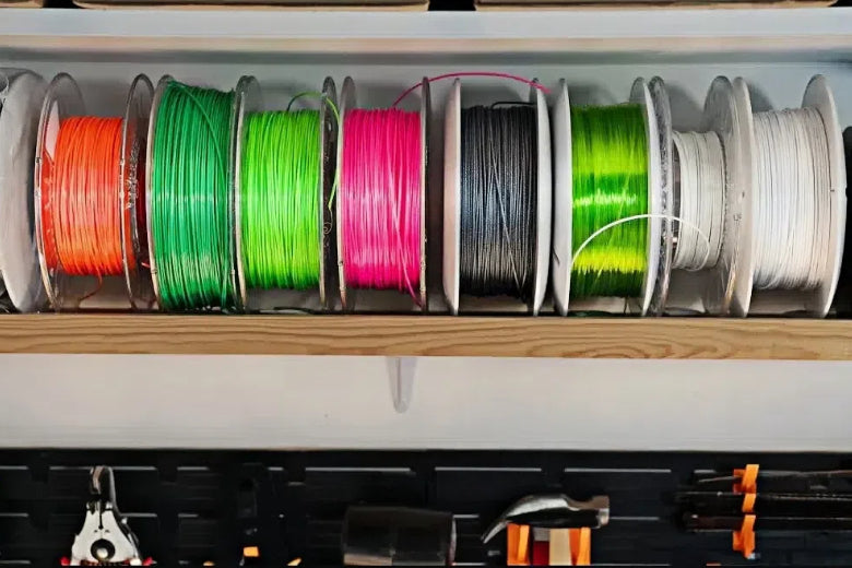

5. Keep Filament Dry
Moisture absorption causes bubbles and erratic extrusion, worsening stringing.
How to Prevent Wet Filament:
  • Store filament in sealed bags with desiccant.
  • Use a filament dryer (or food dehydrator) before printing.
  • For severe moisture issues, bake PLA at 45°C for 4–6 hours (higher temps can warp it).
Test for Moisture: If your filament makes popping sounds while extruding, it’s too wet.
