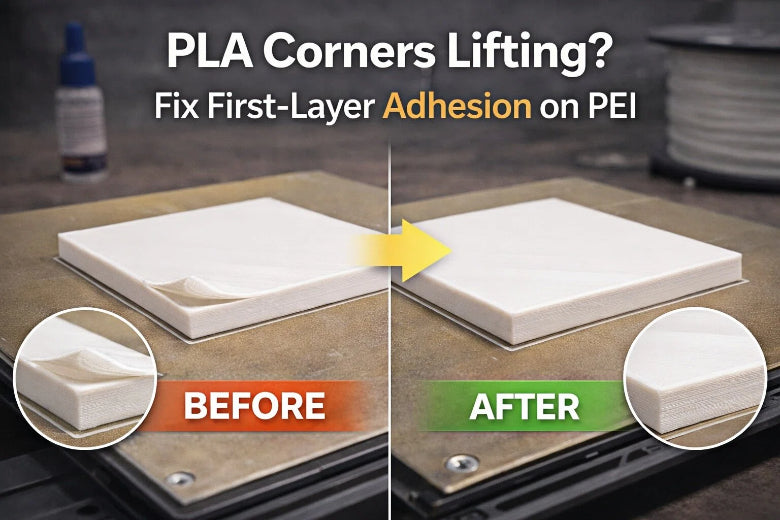

When PLA corners start peeling up during the first layer, you’re not dealing with “mystery adhesion.” You’re dealing with a handful of repeatable causes: a PEI sheet that’s not actually clean, first-layer contact that’s slightly off, or cooling/airflow that’s pulling heat out of the part unevenly.
This is a fast troubleshooting checklist for maker spaces and school labs using PLA on smooth PEI.
Quick diagnosis (30 seconds)
Before changing five settings at once, figure out which bucket you’re in:
Does the first layer look under-squished?
  • Signs: gaps between lines, round “spaghetti-like” beads, edges not pressed flat.
  • Likely cause: Z-offset a bit too high or the bed isn’t level.
Does it stick at first, then corners curl up as the layer cools?
  • Signs: the first lines look OK, but corners lift as the perimeter grows.
  • Likely cause: uneven cooling/drafts, bed edge heat loss, or first-layer cooling too aggressive.
If you’re seeing corner lift, it’s usually #2 plus a little of #1.
