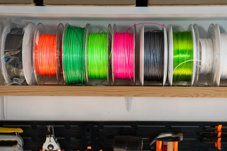

Choosing High-Quality Filaments and Materials
Good filament is key to a strong first layer. Bad filament can cause uneven layers, poor sticking, or clogs. Using high-quality materials gives smoother prints and fewer problems.
Here’s what to check when buying filaments:
  1. Consistency in Diameter: Good filaments have even thickness. Uneven ones can clog or make rough layers.
  2. Material Purity: Pure filaments without fillers stick better and make stronger prints.
  3. Compatibility with Your Printer: Make sure the filament matches your printer’s needs. Some need specific heat or bed types.
  4. Reputation of the Brand: Trusted brands usually have better quality. Check reviews from other users.
Popular filaments include PLA, ABS, and PETG. PLA is easy to use and great for beginners. ABS is strong but needs more heat. PETG is tough and flexible, making it very useful.
Pro Tip: Keep filaments in a dry, cool place. Moisture can ruin them and lower print quality.
Using good filaments and the right adhesion aids improves your first layer. These small changes can make your 3D prints much better.
