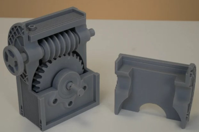

How to assemble 3D printed parts
Properly assembling 3D printed parts is crucial for ensuring strength and longevity. Misaligned parts can reduce tensile strength by up to 30.35%, which highlights the importance of precision during the process to assemble 3D printed parts. By focusing on preparation, alignment, and bonding, you can optimize durability and functionality. Take the time to assemble 3D printed parts carefully to achieve professional-quality results.
