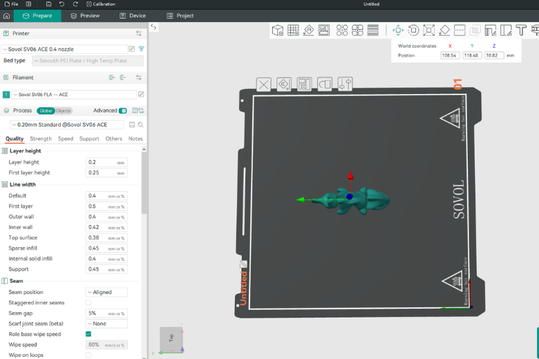

Key Settings in OrcaSlicer
Fine-tuning the settings in OrcaSlicer can significantly enhance your 3D printing experience. By understanding and adjusting key parameters like layer height, retraction, and Z-hop, you can achieve optimal print quality and reduce common issues. Below, we’ll explore these essential settings in detail.
Layer Height and Print Speed
Layer height and print speed are two of the most critical factors influencing the quality of your prints. Layer height determines the thickness of each printed layer, directly affecting surface smoothness and detail resolution. A smaller layer height, such as 0.1 mm, produces finer details but increases print time. Conversely, a larger layer height, like 0.2 mm, speeds up the process but sacrifices some detail.
Print speed, on the other hand, controls how fast the printer moves while extruding filament. Slower speeds, typically around 40-60 mm/s, allow for better adhesion and precision, especially for intricate models. Faster speeds, such as 80-100 mm/s, are suitable for simpler designs but may compromise accuracy.
Tip: Start with calibration test to find the balance between layer height and print speed that works best for your project. Adjust these settings incrementally to observe their impact on your prints.
