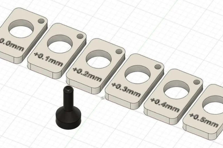

Testing accuracy ensures parts match the design. Start by printing a test object, like a calibration cube. Use calipers or micrometers to measure it. Check for size differences and adjust your printer settings if needed.
A study compared SLA and FDM printers using jaw models. It showed both methods work well in dental practice. FDM prints were as accurate as SLA prints.
FDM prints may need extra steps like sanding to meet strict tolerances. Advanced control methods in 3D printing also improve accuracy.

Getting a perfect fit takes testing and improving. Print a prototype, measure it, and find areas to fix. Change your design or printer settings and try again until it fits right.
