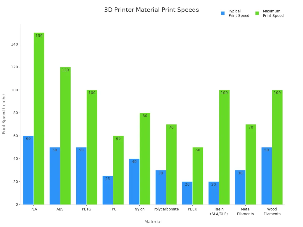

Different printers and materials have their own best speed ranges. For example, PLA works well at 50-70 mm/s, but flexible materials like TPU need slower speeds. Here is a chart that compares normal and top print speeds for popular materials:
Bar chart comparing typical and maximum print speeds for various 3D printing materials
