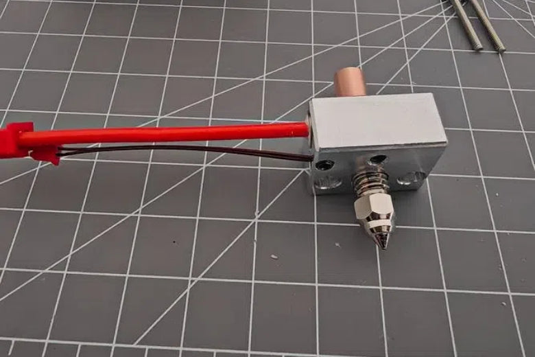

Monitoring Hot End Temperature
Thermistors are key to checking the hot end's heat. The hot end melts the filament before it is printed. Keeping the right temperature here is very important. It helps the filament flow smoothly and avoids clogs or uneven printing. A thermistor, like the 100K 3950 NTC thermistor, measures this heat nonstop. It sends the data to the printer's control board. The board then adjusts the heater to keep the needed temperature.
This careful monitoring also stops dangerous problems like thermal runaway. If the thermistor notices a sudden heat change, the printer can shut off the heater. This prevents overheating or damage. Broken thermistors or wrong readings can cause unsafe heat spikes. This shows why thermistors are so important for 3D printing.
Tip: Check your thermistor often to avoid print problems.

Hot End Temperature Regulation
Thermistors help control the hot end's heat in 3D printers. The hot end melts the filament before printing. Keeping the right heat ensures smooth filament flow. A thermistor checks the nozzle's heat and sends updates to the printer. This helps the printer adjust the heater and keep the temperature steady.
For example, when using PLA, the hot end should stay between 190°C and 220°C. If it gets too cold, the filament won’t melt and may clog. If it gets too hot, it can cause stringing or bad prints. Thermistors allow precise heat control, making prints consistent and high-quality.
Tip: Check your thermistor often to avoid problems from wrong heat readings.
