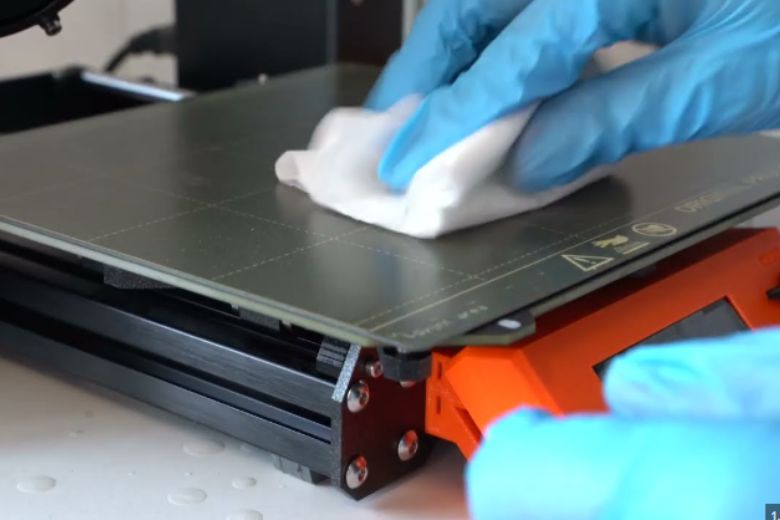

Cleaning with Isopropyl Alcohol or Soap
After you remove loose debris, you can use cleaning techniques with household materials to clean 3D print platform surfaces thoroughly. Both isopropyl alcohol (IPA) and dish soap work well, but each has its best use.
Cleaning Method
Effectiveness on Oils and Residues
Risks and Considerations
Dish Soap
Lifts and removes oils and residues; rinses cleanly.
Safe for all build plates, including textured PEI. Avoid scented or harsh soaps.
Isopropyl Alcohol
Removes oils and residue quickly; good for deep cleaning.
Use 70% for glass beds, 99% for PEI. Can leave residue if used improperly. Avoid ethyl alcohol.
  • For most build plates, use a few drops of mild dish soap (like Dawn) with warm water. Wipe the surface with a microfiber cloth, then rinse and dry with a clean towel.
  • For glass beds, use at least 70% IPA on a microfiber cloth. For PEI beds, use 99% IPA. Wipe the surface gently to remove oils and fingerprints.
  • Avoid acetone on PEI surfaces, as it can cause damage.
  • Always dry the clean bed with a lint-free cloth to prevent water spots or streaks.
Tip: For stubborn glue or residue build-up, you can use a small amount of acetone-based nail polish remover on glass or metal beds. Let it soak, then scrape gently with a plastic scraper. Never use acetone on PEI or BuildTak surfaces.
Tools: Microfiber Cloth, Plastic Scraper, Brass Brush
The right tools make print bed cleaning easier and safer. You do not need expensive equipment—common household items work well.
  • Microfiber cloth: This soft cloth traps dust and oils without scratching the build plate. Use it with IPA or soapy water for best results.
  • Plastic scraper: Use this tool to lift off prints and scrape away stubborn residue. Always use plastic, not metal, to avoid scratching the clean bed.
  • Brass brush: For textured or metal build plates, a brass brush can help remove stuck-on debris. Use gentle pressure to avoid damaging the surface.
Other helpful tools include a soft brush for dust, a vacuum with a HEPA filter for fine particles, and a damp towel for wiping down the area around your printer.
Note: Always inspect your tools before use. Replace worn or damaged tools to avoid scratching or damaging the build plate.
By following these cleaning techniques, you keep your build plate in top condition. Regular print bed cleaning helps you prevent residue build-up and ensures every print sticks well. Clean 3D print platform surfaces before each print to get the best results and extend the life of your printer.
