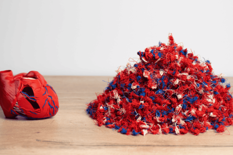

3D printing waste comes in various forms, each with unique characteristics and challenges. Failed prints, support structures, and leftover filament are the most common types. These materials often consist of plastics like PLA, which is widely used due to its biodegradability under industrial composting conditions. However, improper disposal of PLA can still contribute to environmental issues.

Recycling failed 3D prints is one of the most effective ways to reduce waste. Failed prints, support structures, and leftover filament can be repurposed into new materials, minimizing environmental impact. To recycle failed prints, you need to follow a systematic approach:
  1. Sort and Clean: Separate failed prints by material type, such as PLA or ABS. Remove any contaminants like dust or adhesives.
  2. Shred the Material: Use a filament shredder to break down the failed prints into smaller pieces. This step is crucial for preparing the material for further processing.
  3. Melt and Extrude: Feed the shredded material into a filament extruder. The machine melts the plastic and reshapes it into new filament spools.
