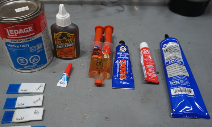

When you work with Sovol PLA filament, you need to choose adhesives that bond well with PLA. Not all adhesives interact the same way with PLA, so you must select options designed for plastic or specifically for PLA. PLA-specific adhesives, such as cyanoacrylate (super glue), Weld-On 16, Loctite 4062, and epoxy, offer reliable performance. These adhesives create strong bonds and maintain the quality of your assembly. J-B Weld Plastic Bonder and SCIGRIP 16 also work well for complex assemblies and interlocking parts. You should avoid general-purpose glues that do not mention compatibility with PLA, as they may not provide the strength or durability you need.

You must match the best glue for PLA to your project’s needs. For quick repairs or small joints, cyanoacrylate glue (super glue) works best. It sets quickly and creates a strong bond between PLA parts. For larger assemblies or load-bearing joints, epoxy or J-B Weld Plastic Bonder provides extra strength and durability. Weld-On 16 and SCIGRIP 16 are solvent-based adhesives that chemically bond PLA, making them ideal for complex assemblies and interlocking parts.

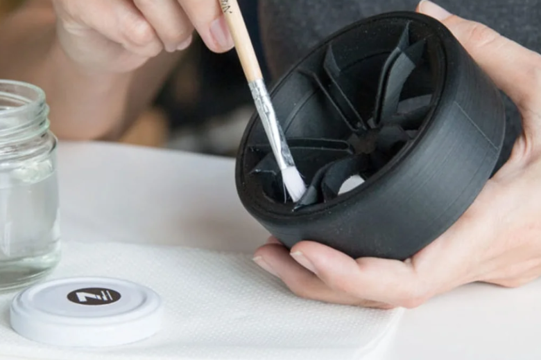

You need to follow a systematic approach when learning how to glue PLA for Sovol filament projects. Start by preparing your PLA parts. Clean each surface with isopropyl alcohol to remove dust and oils. Lightly sand the areas you plan to bond. This preparation increases the surface area and improves bonding. Test-fit the parts before applying any adhesive. Proper alignment at this stage prevents gaps and ensures the joints will have maximum strength.
Apply a thin, even layer of glue to one side of the PLA joint. For most basic repairs and small assemblies, cyanoacrylate glue works best. Empirical tests show that cyanoacrylate bonds withstand peel-off forces of about 10.41 N and pressure up to 36.6 kPa, far outperforming silicone-based adhesives. Use a small brush or applicator tip for precise application. Avoid excess glue, as it can seep out and create residue.

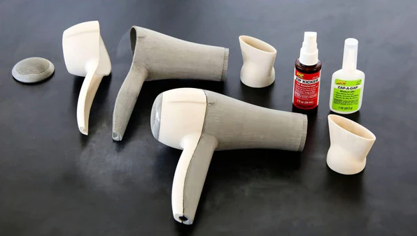

When you assemble 3D printed parts, focus on alignment and reinforcement. Begin by dry-fitting all PLA components. This step ensures that interlocking parts fit together without gaps. If you notice any misalignment, sand or trim the PLA until the fit is perfect. Techniques for precise alignment include using registration marks or guides on the parts.
Apply the adhesive to the bonding surfaces. For multi-part assemblies, work in sections to maintain control over alignment. Press the PLA parts together and use clamps to hold them in place. For interlocking assemblies, ensure that all features engage fully before the glue sets. Reinforce the joints by adding a small fillet of glue along the seam if needed.
