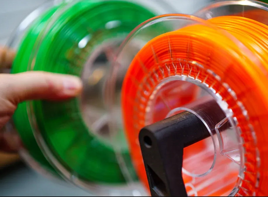

Handling and Storage of 3D Printing Filaments
Proper handling and storage maintain the quality of your filament and ensure consistent printing results. Store your filament in a cool, dry place with stable temperatures. High temperatures can soften or melt the filament, while low temperatures can make flexible filaments brittle. Use vacuum-sealed bags or airtight containers with desiccants to minimize moisture absorption.
Keep filaments away from direct sunlight and heat sources to prevent degradation. For high-humidity areas, consider using filament dryer devices to remove moisture safely. Following the manufacturer’s recommendations for storage temperature ranges also helps preserve filament strength.
  • Use zip-lock bags with silica gel packs for simple storage.
  • Invest in dry-storage boxes for better moisture control.
  • Maintain a clean and dust-free storage environment to protect the filament.
Note: Moisture can weaken your filament and cause bubbling during printing. Always store it in a dry environment.
