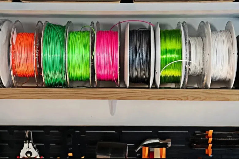

Filament Storage Best Practices
You can stop stringing by storing filament the right way. Use airtight containers to keep moisture out. Add silica gel packets for extra protection. This is important for nylon and TPU. For PLA, a sealed bag works if you keep it cool and dry. Always avoid sunlight and keep the temperature steady.
- Store filament in airtight containers.
- Use silica gel for types that need extra care.
- Dry wet filament with heat, not just by waiting.
- Keep all filament away from sunlight and heat.
Short-term fixes like slicer settings help quickly. Drying and storing filament give long-lasting results. Here is a quick comparison:
