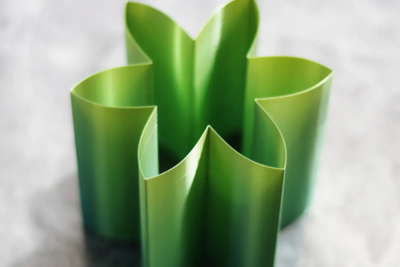

Printing Techniques to Hide Layer Lines
3D Prints
Reduce Layer Height
You can make your 3d prints look much smoother by lowering the layer height. When you use a smaller layer height, you get thinner layers. This change helps hide layer lines because the stair-step effect on curved or sloped surfaces becomes less obvious. If you set your layer height to 0.1 mm or even lower, you will notice a big improvement in the finish of your 3d printed parts. The surface feels smoother, and you may not need as much sanding later. Keep in mind, though, that printing with thin layers takes more time. Your 3d prints will look better, but you will need to wait longer for them to finish.
Use Fuzzy Skin or Texture Features
Sometimes, you do not want to spend hours sanding or painting your 3d prints. You can try a different trick—add a texture right in your slicer. Many slicers now let you enable smoothing features like "Fuzzy Skin." This setting makes the printer move in a zig-zag pattern, giving your 3d printed parts a soft, rough feel. Here are some cool things about using fuzzy skin or texture features:
  • You can hide layer lines and small defects without extra work.
  • You can adjust how rough or soft the texture feels.
  • Your 3d prints will look unique and less like plastic.
People who use this feature say it saves time and makes it hard for others to tell the part was 3d printed. If you want to cover up layer lines fast, this is a fun option.
