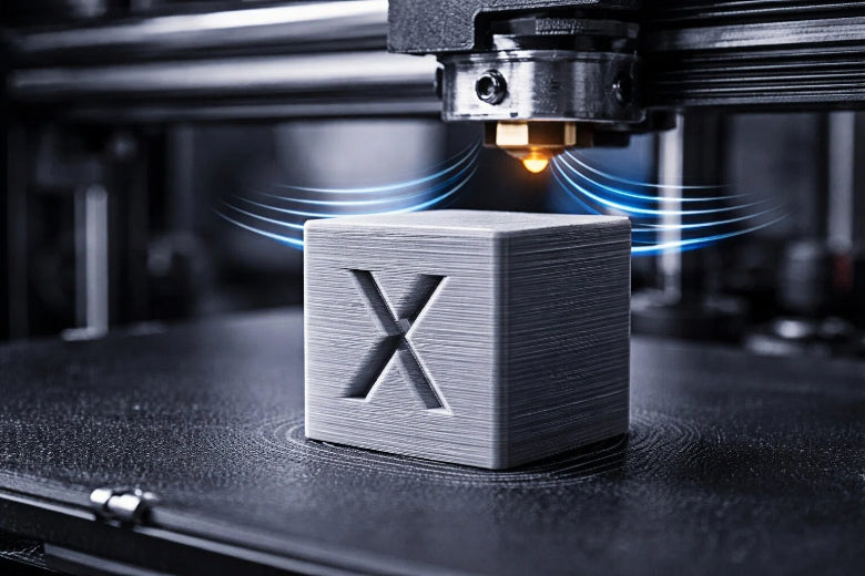

You can check for ghosting in 3d printing with easy tests:
- Visual Inspection: Look for light, repeating lines that follow the print’s shape.
- Calibration Models: Print cubes or towers with sharp corners to show ghosting.
- In Situ Monitoring: Watch your printer while it works. Change speed or temperature if you see problems.
Test prints like calibration cubes help you see ghosting better. These models show problems at corners and straight lines. You can use them to connect ghosting to how your printer moves. If you see ghost images, brightness changes, or spaces, you know ghosting is happening.
